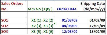

No u won’t be able to combine orders . Same item’s combined production order is created when u create a Project Order from Sales Order. Reason : Why it is not combined is system assumes that delivery dates of all orders will not be same.
Perhaps I am reading this differently but a replenishment method of fixed reorder and a reorder cycle of more than 14 days would give you the output you want.
When the planning engine runs the end date would be, depending upon a variety of settings, when you need it to fulfil demand. In your example where production orders are combined within a reorder cycle then this would be the shipment date of the first order due. The start date is automatically calculated back from the end date using a variety of settings and capacity along with teh routings or lead time of the item.

From your description and my understanding of it my solution works as standard, Alain has modified the system to handle a specific requirement. Your requirement is actually different - his would have been to load the three slaes orders onto ONE production order, whilst yours is only item based and can be handled without issue if you set the system up correctly.
Use a fixed reorder policy with a reorder cycle of say 20 days, then you will get your three production orders with combined items - there are other ways, but this is one.

I have done some customization for it. Creating a new option for “Source Type” :: Combine,( “Source No.” := Item Nos.) on the production order. And customizing the codeunit for the “Sourc Type” :: Combine, which puts the sales lines( for the same ITEM) on one production order. it is working fine.
