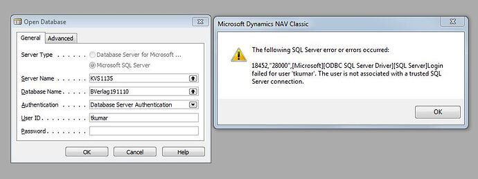

I have Nav 2009sp1 installation and sql server 2008 running on same machine.
Yesterday while trying to make some changes in navigation pane i got an error that i don’t have user rights to do so.I was logged in on nav 2009 sp1 classic client with windows authentication. I was a super user and hence had all rights. I tried to check on database login on nav and by mistake changed the role to super(Navipane).
Now the problem is when i try to login i cannot see anything in object designer. and i only have rights to make changes in navigation pane. Can you please suggest me if there is any way i could correct this mistake and change my role back to super.
But i was the only user.I tried some more changes and now somehow suceeded in opening the database with SQL authentication as suggested by Amol.
Now i am extracting all the changed files from my last backup and will try to restore the fob in new database.
PS. after creating a new account in SQL database with admin rights i successfully opened my database and now i can even reverse back the role of my username in windows authentication.
