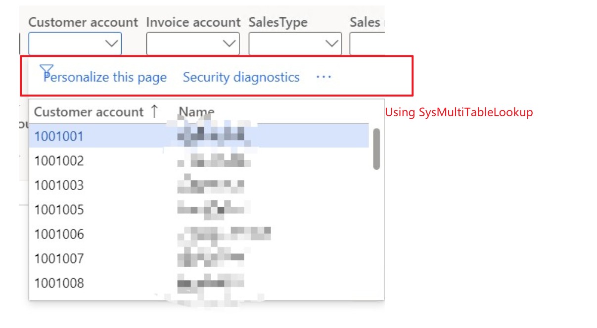

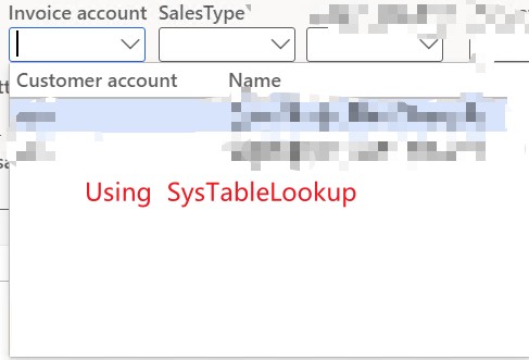

The picture style of the drop-down box loaded using the SysMultiTableLookup class is different from the picture style of the drop-down box loaded using the system standard SysTableLookup. How can I set it to be consistent with the picture style loaded by SysTableLookup

Focus on how you create the form, i.e. the formRun() method. Try formBuildDesign.windowType(FormWindowType::PopUp)
Thank you,It worked, solved my problem
