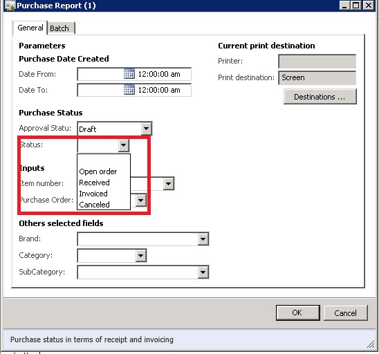

Hi Guys,
I need help here , i create a report and puts some parameters, but one of the parameter has a default value.
how can i remove that? Is there a way ? Please help and guide me…
Please see below image.
TIA.

If you don’t like the default value, change your data contract class and provide a different default value there. Just don’t forget enum fields (such as your status) always have a value (and of the enum elements). If you want to see an empty box, you have to have a valid enum element (often called None) without any label. (But you shouldn’t change the approval status enum.)

i will revise my subject… when i generate the reports the approval status should have an empty value like those parameter such as status,itemid,PO,brand,category, sub category as shown image above…
the default value is 0 which is equivalent to “Draft”, i use SrsReportRunController to show that.
Okay, if you want to an alternative design, use the parts of my answer that applies to enums and assignments and ignore things regarding data contracts and the initialize() method. I still prefer doing it in data contracts, because it’s a better object-oriented design - it respects class responsibilities.
This problem is covered in my first reply: Just don’t forget enum fields (such as your status) always have a value (and of the enum elements). If you want to see an empty box, you have to have a valid enum element (often called None) without any label. (But you shouldn’t change the approval status enum.)

Are you familiar with the concept of enumeration types, or enums? They’re data types defining a fix set of values. If you need an additional value there, you have to change the definition of the enum. In Dynamics AX, all these things are defined in AOT (Application Object Tree); enums are under Data Dictionary > Base enums.
If the enum in your report is the standard Approval Status enum, you shouldn’t try to change it. Instead, create a new enum with four values and later convert it to Approval Status. For instance, if your intention is to use it for filtering, None will mean that there won’t be query range, and other elements will mean a range with a values from Approval Status enum.
