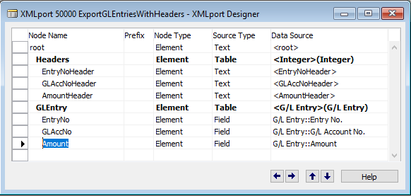

Export them in a separate table element.
In C/AL visual designer it would be something like this:
And the same in AL

Thanks Alex. I have already accomplished this using integer table but there was a blank row just after the header row. Setting TableSeparator = ‘’ fixed the issue.
