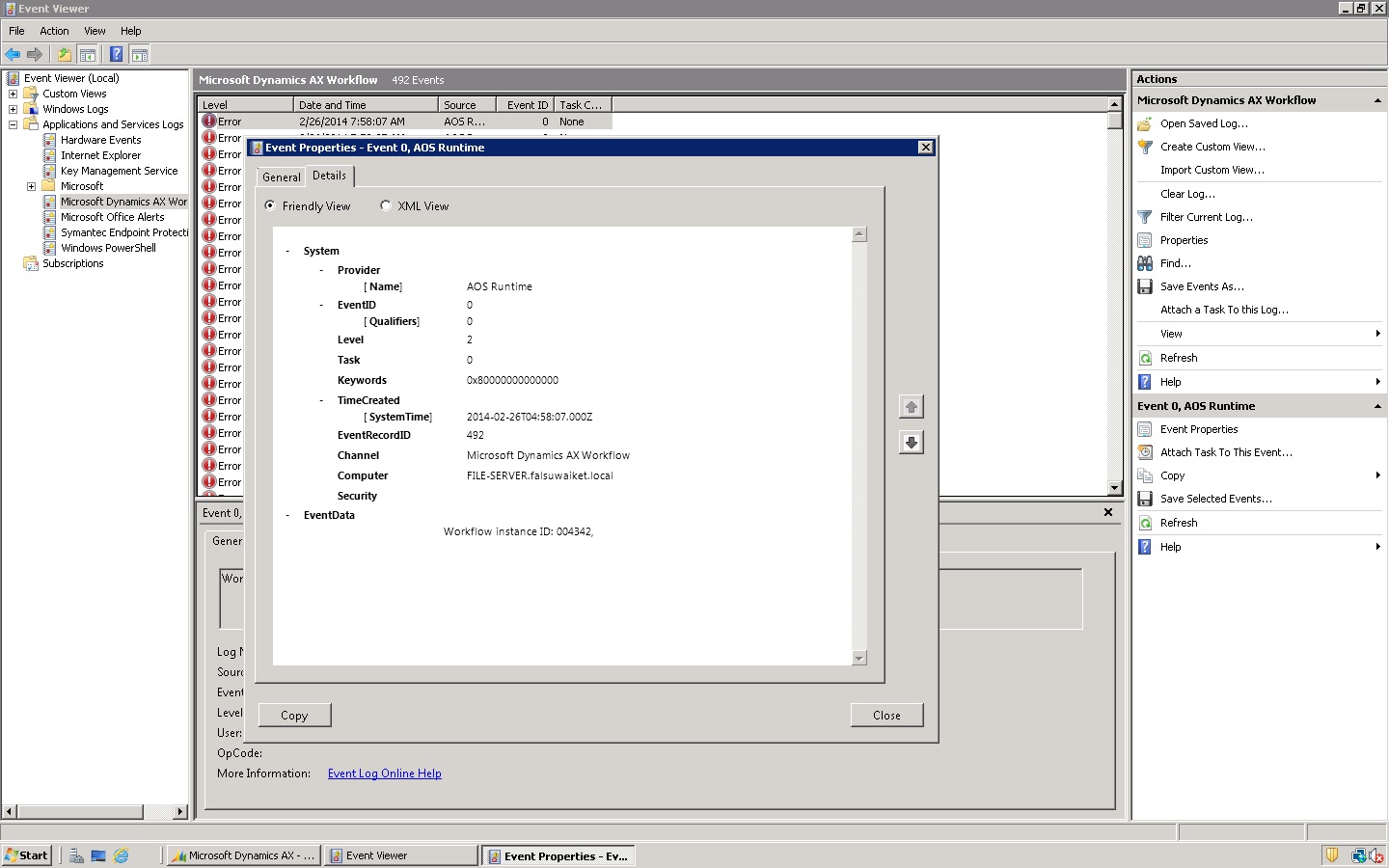

I have issue in our AX purchase requisition workflow. after installation almost 2 months working fine. recently its giving error
STOPPED ERROR:
please find the below screen shots for workflow & event log details also.
Event log screen shot:
Kindly help to solve this issue…

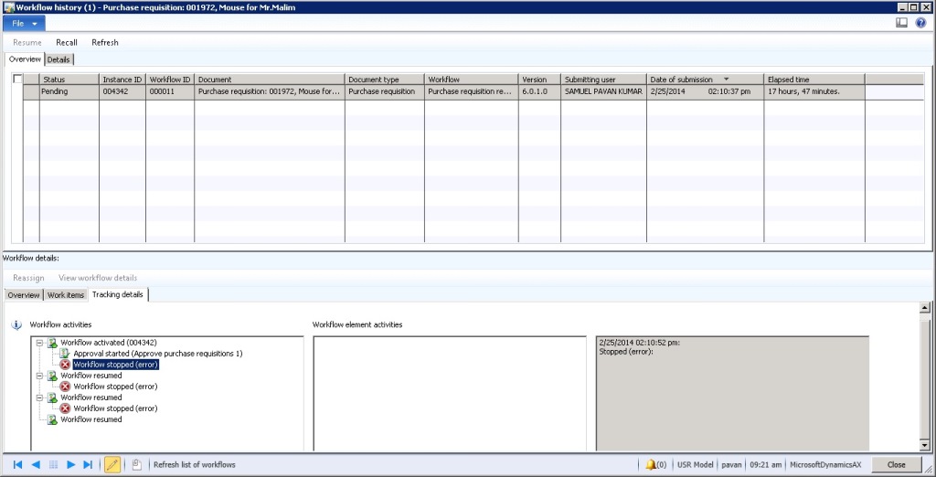

Can you show the Tracking details tab of Workflow history? What’s your version of AX?
hi martin
please find the below of tracking details tab of workflow history & my AX version…
Version of AX
Not much details could be found in Tracking details too. You better post the event viewer message here to understand exact problem.
hi kiran
in main post i already added event viewer message screen shot. there also not much information.
workflow instance ID 004342.
you can check …
