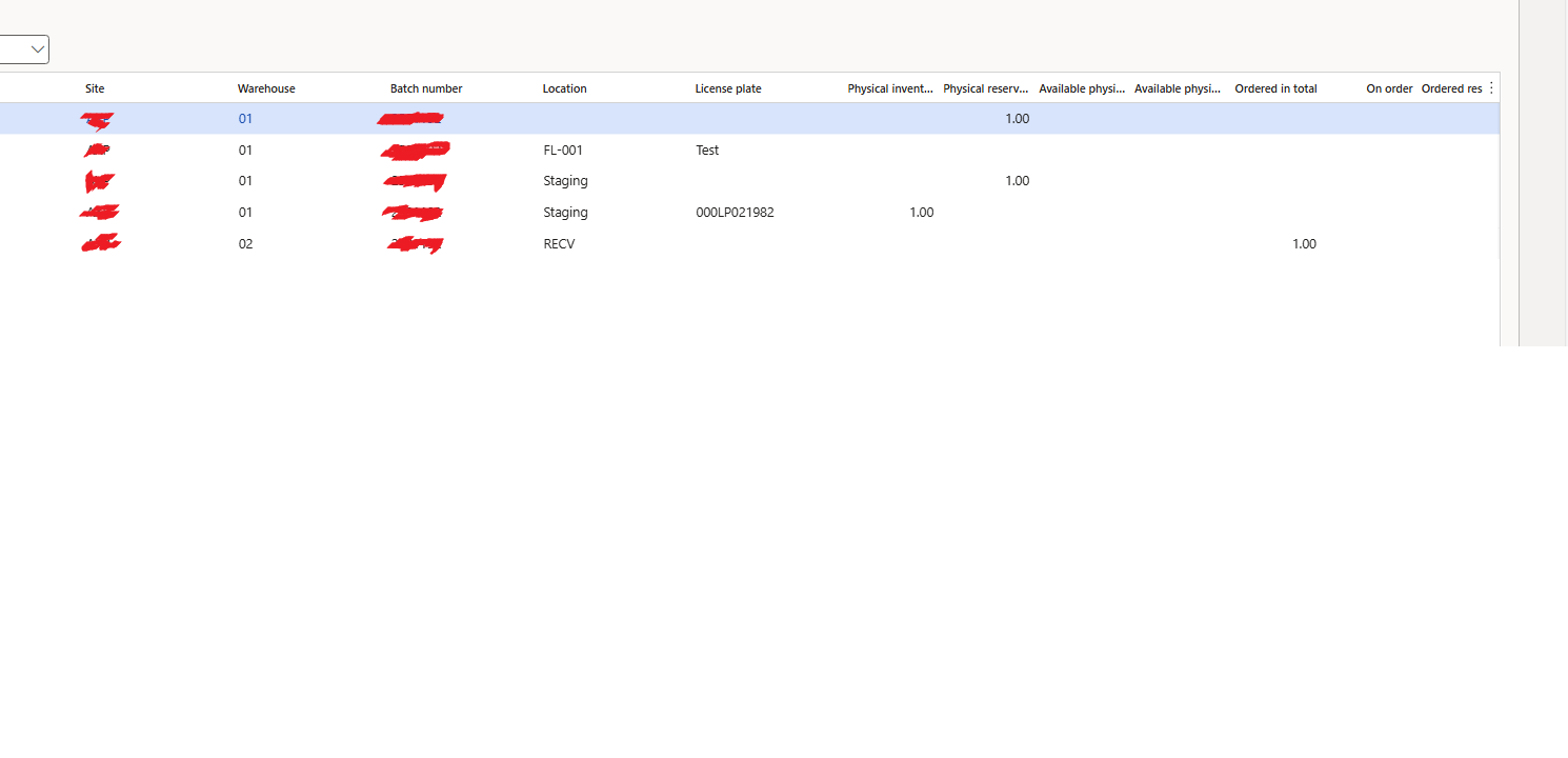

In the transfer order process multi pick and put process, in the second pick is getting an error like qty does not exist for that license plate.
  1. Pick - TestLP (Qty -1)
  2. Put - TestPut01LP (Qty - 1)
  3. Pick - TestLp1 (qty -0).
whsworkExecute.pickWorkLineFromLicensePlate() - getting error
No idea why the qty is not moved from put to pick.
Hi there,
Looks like you have to break the work before second put-pick. That can be done on work class
Rajashree
