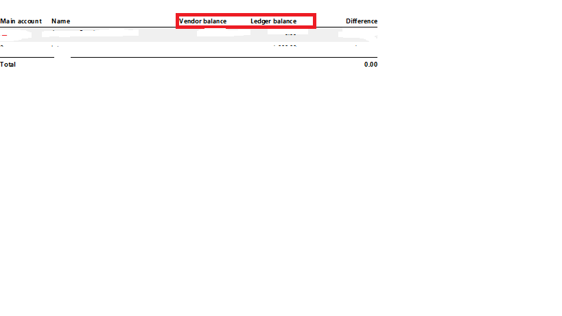

below is the screen shot.
Can you please tell where exactly these fields are populating and inserting into Tmp table

I want to find code exactly l where Ledger Balance(LedgerAmountMST = XXX) and vendor Balance (vendAmountMST=XXX).
But while I debugging all the above methods LedgerAmoutMST and VendorAmountMST is not showing any value even though the report is showing the balances.
