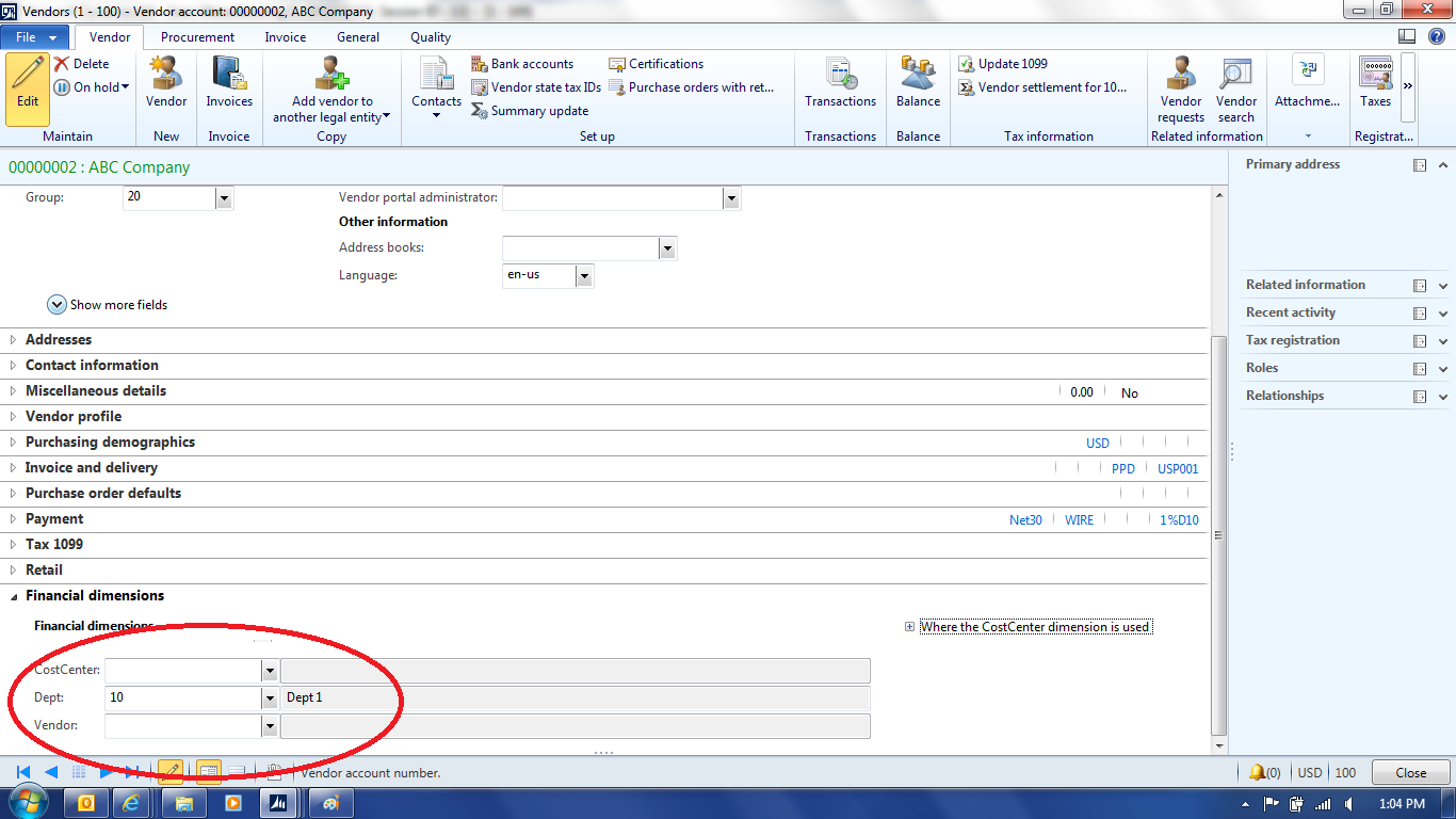

Here is the account structure setup. I did activate it later.
Also I did update financial dimensions of vendor.
Even then financial dimensions doesn’t appear correctly and no error pops up.
Please let me know if I have to check anymore settings.

Sorry in previous post, I updated a wrong snapshot for vendor info.
Lakshmi
Sorry In previous post, I updated a wrong snapshot for vendor info. Here is the correct one
Lakshmi

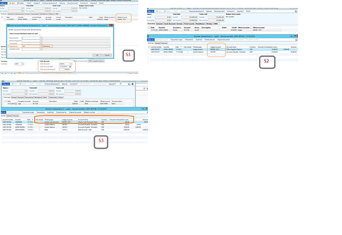

Hi Lakshmi
Follow the below steps and refer to screen shots which i managed to create cash discount entry and get it right.
a. Setup default dimension on vendor master
b. Setup appropriate account structure
c. Post invoice journal – while posting journal verify whether default dimensions populated onto vendor and same are updated to offset account also. Verify whether cash discount code is selected or defaulted from vendor.
d. Verify invoice postings whether Debit entry is posted with dimension.
e. Post payment journal and verify related vouchers- discount value should be posted discount account along with dimension.
Pls. refer to screens.
