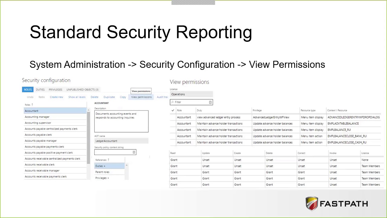

    There are native tools to help with this (Security diagnostics for task recordings - Finance & Operations | Dynamics 365 | Microsoft Learn and How to Simulate the Security Development Tool in Dynamics 365 for Finance and Operations - Alex Meyer) and there are also tools from Fastpath/Delinea that I created to help with this process
