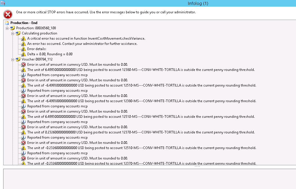

After debugging the code, i found that there is Currency round off value should be mentioned as per the below screenshot.
After updated the General rounding rule value, i’m receiving the below error. Please help me on this asap.

I’ve found the solution for this error. This errors are generated by the posted values of an item has not been applied the general rounded rule for the currency used for the transactions. I’ve ran the below code to make it work in the job.
InventSumReCalcItem inventSumReCalcItem= new InventSumReCalcItem(“ITEM001”,true,CheckFix::Fix);
inventSumReCalcItem.updateNow();
Now the issue is solved for me.
