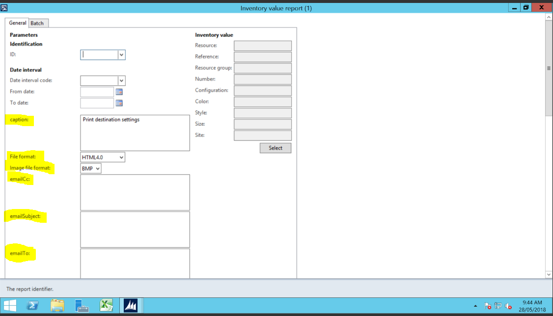

HI All,
I am getting few unwanted parameters in every SSRS report which i am opening in X 2012. Most of them are related to mail.
Why these parameters are there and how we can we remove them. please advise and thanks in advance.

Do you see any changes on \Forms\SysOperationTemplateForm (other than SYS/SYP)?
No There is no changes all are in SYS only…
Have you checked the related classes? SysOperationUIBuilder etc…
Checked … No chnages in any class
Check if there are any customizations on SrsPrintDestinationUIBuilder class.
SrsPrintDestinationUIBuilder class also don’t have any changes.
I would try debugging SysOperationController class, from the prompt() method further when the report dialog is being generated.
Also an idea, if those unwanted fields are on the report contract class as parameters … but it would have to be on each contract class, whose report you encounter this problem on, so it is not very likely.
Check the output method in the report. if it has any other condition matching. check if there are more design to the same report.

Only in Production environment getting this error in all other environments it’s working fine. Also, it’s coming for All reports, not for a particular report.
Same Parameters are coming in reporters whether it is new developed, customized or statandrad report .
Same Parameters are coming in reporters whether it is new developed, customized or standard report.
For all the users?
