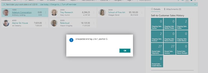

I have a simple variable text XMLport which imports data into two fields of a custom table.
But I get the following error when I pass ‘invoice’ as transaction type and transaction ID 1.
This is how I’m testing it:-
I am clueless on what is wrong. Any help would be highly appreciated.
