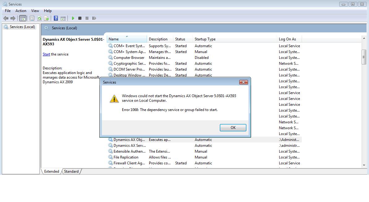

I’m trying to login into my AX 2009 Virtual system but I’m getting error like its mentioned in the screen shot. From last 3 days it was giving me message like to change my password. so today i changed my password and restarted the system. from then I’m unable to login into AX 2009 system and when i tried to see services are running or not then i tried to start it manually then i’m getting this error. Please someone help me how to make AX 2009 start run again.

Check whether the sql server services are started or not, if not start those services and then start the AX service.
Hi Naresh,
Yes i did it. After i posted here, then i thought of the same (i mean to check the server) and as it was disabled, i enabled and went to properties and selected the Local system as LOGON. … Now its running.
