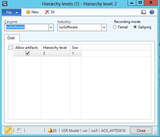

File>Tools>Task Recorder
Configuratians is Settings>Parameters
Congurations is Settings>Industry
Configurations is Settings>Framework
Configurations is Settings>Hierarchy
Configurations is Record>New node
(Müşteri = Customer) , (Kaydet = Save)
I do click save, this error
after I do click start, this error:
The second error may be just a consequence of the first error. Can you debug the code, please, to collect more information about what’s failing?
