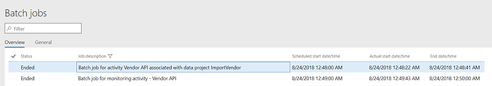

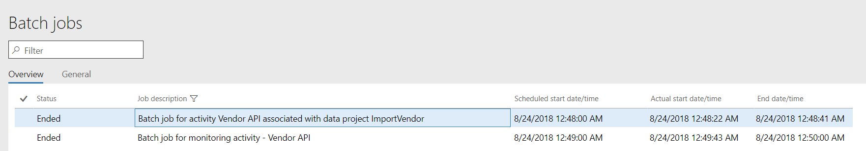

When i create recurring api to import file. Batch job is ended.

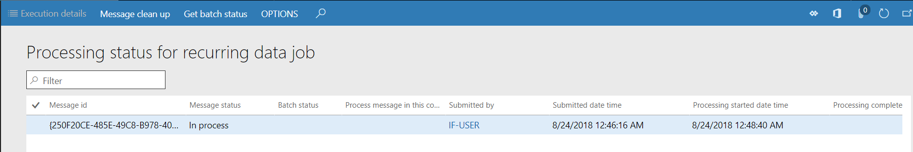

And when checked Manage schedule data job > recurring data job :Status of task ID in is “In process” but not “Processed”.
How to know why it’s not work OR when task ID ended /error ? Where i could check status import job of file is received from API?
Form “Batch Job”
Form "Recurring data job "
