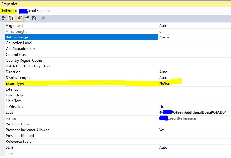

is CreditReference enum filed? Why you storing it as int value. And also update your checkbox value in the table
Thanks for the response.
Updating the checkbox value in the table is what I am having trouble doing. How should the check box value be updated in the table? Why it is stored as an int, I am not sure. I haven’t worked on this one in a little bit so I don’t quite remember my thoughts on that. I am unsure what you mean by is CreditReference enum filled. It has Enum Type NoYes and is its own EDT.
You should write the code as follows…
tablebuffer.creditreference = Noyes::Yes or Noyes::No;
Based on your checkbox value.
Everything is running through the PurchPurchaseOrderHandler class.
