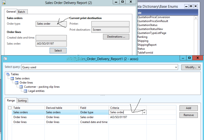

just remove " " from value
it should be only SALES…
u need to use " " at the time of string only
or try to use its enum value like 1,2,3
tried it kunal still it is editable

Issue:
Locking or hiding a range for a report parameter is not working. At runtime, the parameter is enabled and the user is able to filter on the range. This occurs when a report is bound to a query that has a range value with a Status property value of Locked or Hidden.
Additional information for troubleshooting:
SQL Server Reporting Services does not honor the query range Status property.
So you can’t achieve it using Query Range with lock/hidden property.
