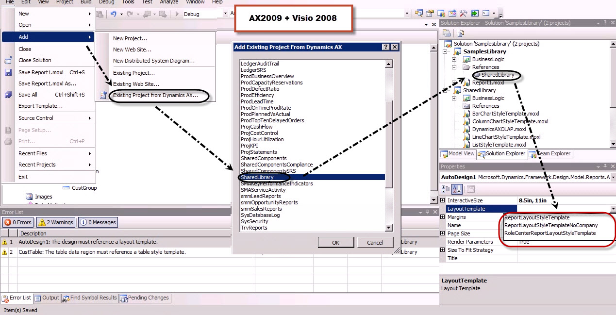

I am studying Report Design with 2009 documentation but try to follow it with a AX2012 system. I have the following problem:
Where are the LayoutTemplates in Visual Studio 2010?
you can click on the screenshots to see a larger copy:
If you click on Auto Design or Precision Design properties, u may get that Layout template properties. If u need to change any style template properties, then go on design table properties and try to change it. Normally both layout and style template had 3 default properties.
