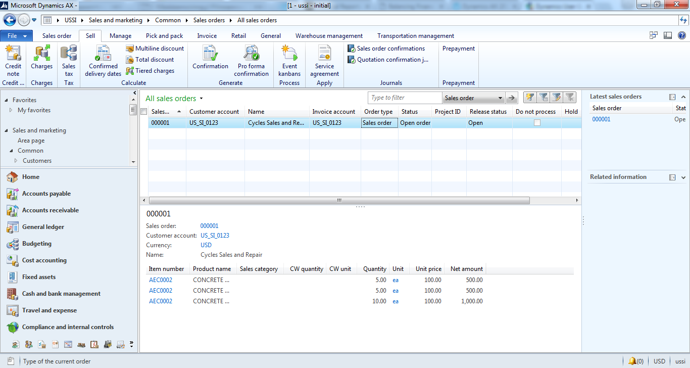

In R3 Demo DB, i confirmed the Sales Order & journal is created in Sales Order Confirmation button. But still Status is not changing from Open Order to Confirmed.
What could be the reason.
The sales status is not updated with the confirmation. It will be either Open order (or) Delivered (or) Invoiced (or) Cancelled.
The document status will be updated after posting the confirmation.
Normally when we confirm the SO, the SO button will be disabled. But here its not happening… Still enabled even after generating Confirmation.
I don’t think it is so in standard AX. However you see this behavior in PO confirmation that once you generate, Approval status will be changed to Confirmed and the Confirm option is disabled until there is any change in PO again.
