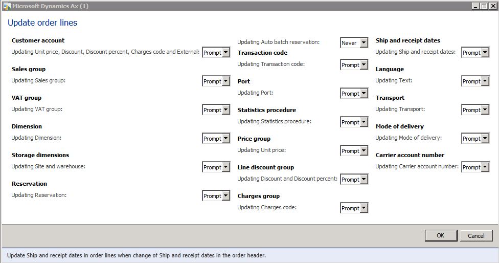

are you not getting the popup “Update order lines”, when you update the date? did you selected the check box in the that popup??

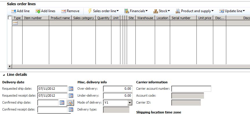

Open a new sales order, click on the header view, enter the requested receipt date and ship date, as per example:
These dates will be the defaults on all new sales order lines entered, as example:
If you add lines, then subsequently change the requested ship / receipt dates in the header, then you ‘could’ have a pop up to warn you and prompt you to update this dates, if the sales ledger parameters > Updates > Update orer lines is set to do so, as example:
You still need to confirm the ship and receipts dates … if you wish …

All the parameters are set at prompt
