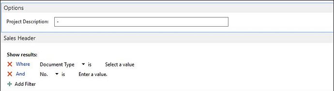

My problem is that i have a new button on the Sales Quote Page “Create Project”, this button invokes a Report with a Request Page, on this Request page i want to type in the name of the Project. That works, but i want to preassign the field with the “No.” of the Quote and the name of the Customer.
My Question is how can I make it that the request page knows that it belongs to the current data set ?

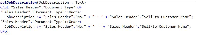

Hello Pramod,
I did all these steps, but now the field is not preassigned, but nevertheless my Problem above is solved. Now I have a other Problem :frowning:

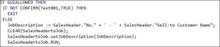

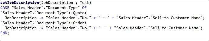

Here is my function in the Report :
Here I use it on the OnOpenPage() Trigger :
And that´s what I do in the Page :
What have i made wrong ?

Hello,
Please assign value to “JobDescription” in “Create Project” Action.
Like:
Case …Document Type.
And I think don’t need to write CASE Statement because in both case you done same. Just write:
JobDescription := “Sales Header”.“No.” + ’ - ’ + “Sales Header”.“Sell-to Customer Name”;
CLEAR(SalesHeadertoJob);
SalesHeadertoJob.setJobDescription(JobDescription);
SalesHeadertoJob.RUN;
Create global variable JobDescription1 &
In “setJobDescription” function
setJobDescription(JobDescription:Text)
JobDescription1 := JobDescription;
And use “JobDescription1” to meet your requirement.

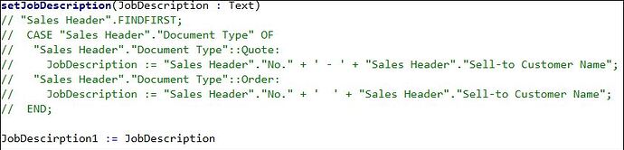

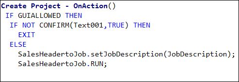

Now it shows an empty field. I´m gonna show you what I have done.
In the “Create project” On Action Trigger :

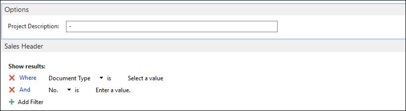

Now we are in my Request page :
In the Code of the Request Page is my function :
And on the OnOpenPage Trigger i run the function. What did i made now wrong ? :frowning:
Thanks for your help :slight_smile:
Hello,
All are correct, but something wrong in report.
  1. Don’t call “setJobDescription” function in “OnOpen” trigger & remove global variable “JobDescription”.
And check it will work. [:)]
Hello,
It doesn´t work [:’(]…it just shows " - " and not the No. and the Customer Name… i think the request Page doesn´t know that it belongs to the current dataset ?
Hello,
Last change:
Please Check “Create Project” action
JobDescription := “No.” + ’ - ’ + “Sell-to Customer Name”;
Remove SalesHeader & check.

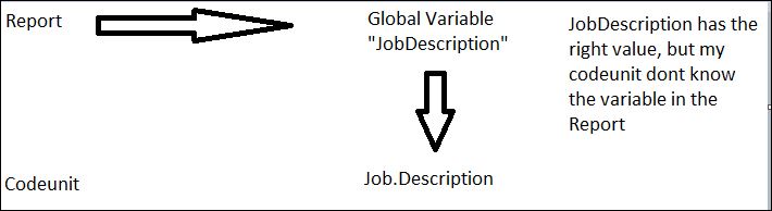

Can I write my Global Variable Value into to an field in the Table “Job” ?
Problem :

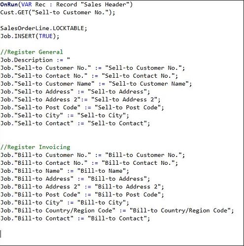

I have an Codeunit which inserts a new Project and it also insert the given Fields in the Sales Quote/Order, but how can i manage that the value of the Field "Project Description "in the Request Page fills the Field Job.Description in the Codeunit .
My Codeunit :
Hope you understand my problem [:D]
Thanks for Replies
Hi Moritz,
What is Link Between Codeunit and Report …how those interact with each other…
If you want job description from Report then Create a Global Funtion in Codeunit. which takes 2 parameter 1st is Sales Header nO and Other is jobdescription …
So when you call codeunit from report you would Pass them as Parameter So directly you can get jobdescription…
No Setrange for your sales No or whatever you want insert those values to Destined fields …
If you need any help let us Know…
Hi Mortiz,
Please pass that global variable to that codeunit.
Thank You
Mahesh U
Hello,
Thanks for the replies.
So i added a new global function “getJobDescription” With Paramters “SalesHeaderNo” and “JobDescription” :
My Report look now like this
Sales Header - OnAfterGetRecord()
MakeJobfromSalesHeader.getJobDescription("No."JobDescirption1);
MakeJobfromSalesHeader.RUN(Rec);
COMMIT;
What have I made wrong ?
Sorry buts its my first time using/programming a Codeunit. [8o|]
Ok wrong DataType on my Parameter :smiley:
But what must I write in my Function ?
