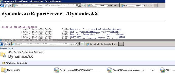

HI thak for your quick replay,
here i can access to web service URL and i can get all report deployed and i can access to the Report Manager URL and is fonction correctly ,but the issue is when i want deploy the new report in visual studio or in AOT , i get the error message that i already montionned
