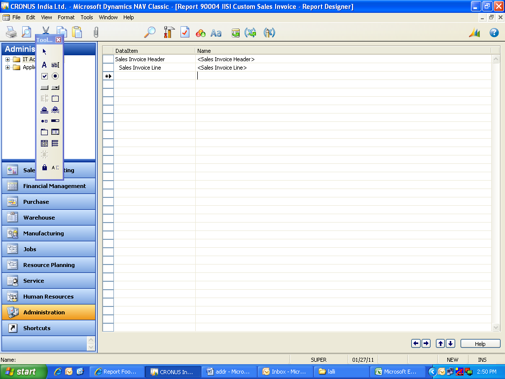

I have imported your FOB file but whenever I click on the design button my navision restarts. what’s your navision version? does it have any service pack?
mine is NAV 2009 sp1
ah, that’s why it shows errors. i used navision 5.0
oh! kay i will giv the snapshot of the section n deginer. do frm tat ten
(2.25 MB)
mmm i hav indicated the modification i hav done in red! use transfooter and keep shape (hort) with 40 as height. rest you have to code.
where will i code and what will my code do?
you should code in the data item triggers, you code shold tell the report to stop when the last record is retrived from table.
i already told how you can code, thats just the idea i dont know the correct code, but it should come something like this:)
All the best:)
