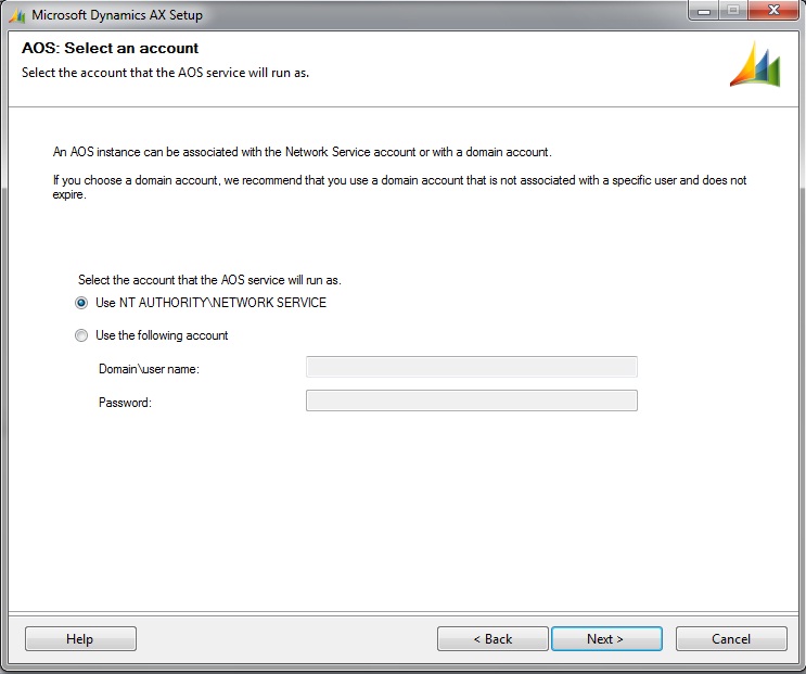

if you get the error. you must open the ax with the user that installed the AX
Re- install the AX when the installation screens like one below
select the above option
