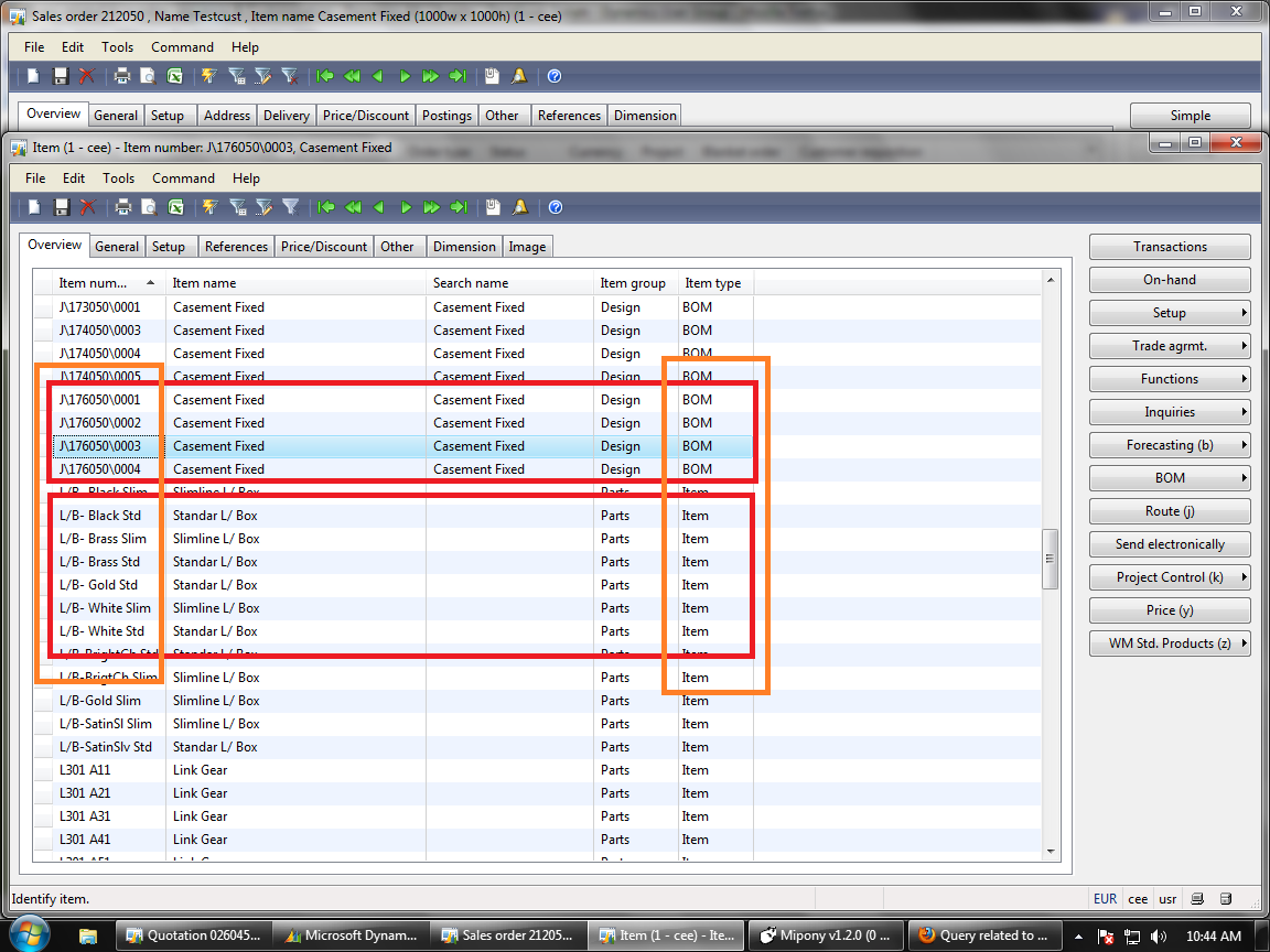

I have a user requirement to customize inventTable form for BOM type & Item Type of item creation
e.g BOM type of item creation will be base on some parameters like some EDT and Enums etc. .
user will select these parameters on that basis BOM type of Item formation should happen.
above req. i have fullfill.
Now user want for Item Type of item, standard number sequence should use.
how to map this process? pls let me know if somebody know.

see there is three type of item type ITEM , BOM & Service
user want Item type of item creation will be on base of number sequence only which is available in Ax.
but for BOM type of item number seq. not needed , BOM type of item creation will be base on some parameter selection which i developed.

there is need one no. seq. only for Item type of item
and for bom type user will select some values from EDT & enums on that basis bom type of item number will create.

I have a doubt Item type number sequence format is different than BOM type of item.
hence , system was throwing an error “Number GTD044FRDH475JT does not match format ######.”
because number seq. length is 6 for item type item. and for BOM type its 15
Hence in class \ NumberSeq i have comment that code in four method like checkSetupReserve , checkChangeNumber,numCheckFormat, and numRemoveFormat. now its working as i required.

if unchecked continues and remove the changes from NumberSeq ,system throw an error at the time of record saving.
’ Number 1OGC04HRYDKM6J does not match format ######."

So to skip the validation format of Item number seq. only I debug program and find out there is need to comment only one line.
because it’s validating number sequence format between Item type of item ( Auto number seq.) and BOM type/parameterize string number. Item Type has 6 digit format and BOM has 15 digit string. That is why it was not allowing.
Commented line is “ ret = element.numberSeqFormHandler().formMethodDataSourceValidateWrite(ret) && ret;
Which is located at Form- InventTable --Datasource–InventTable—validateWrite
Now both type of item no. seq. are working fine.( auto number seq & BOM type parameterize string(Number seq.)
it’s working as I desired.
