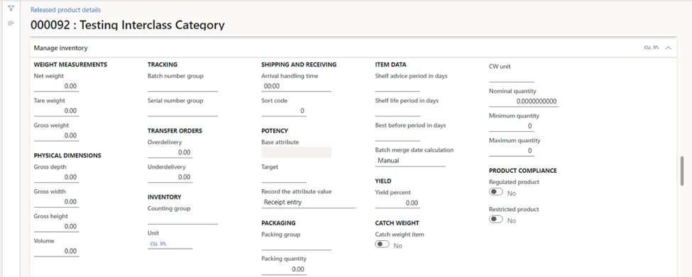

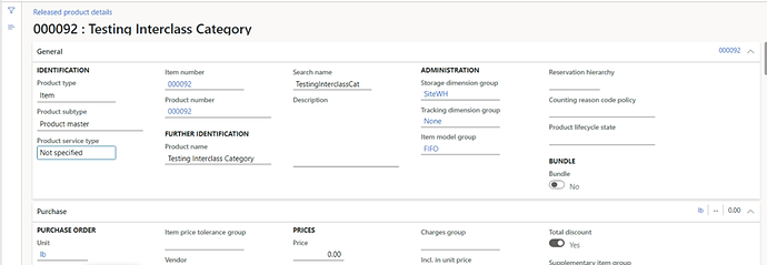

To solve this problem, we will first create a Product Master, in this example we have created a product called “Testing Inter Class Category”, in which Purchase unit in lbs . and Inventory units are in cu.in.

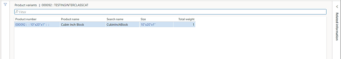

To match the question specification, I have created a Product Variant for this particular product number (000092) and give a size which is 10”x20”x1”. In the question it only specifies 10”x20”, however since the questions refereeing the unit, which is in cu.in, I have assumed the third dimension which 1” to make the unit cu.In. Otherwise, two dimensions will only result in Sq Inches. See the screen shot of variant.

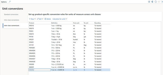

Now go to unit conversion tab – navigation Organization administration – Units – Units Conversion. Select Inter Class Conversion – Provide conversion details and select the associated product. See details on the screen shot below. Conversion factor is 1cu.in = 0.0005 lbs. Calculation details are below:

So, 2000 cu.in = 1lbs. hence – 1cu.in = 1/2000 = 0.0005lbs.

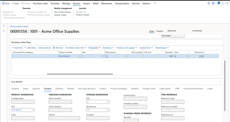

Now, we will create a Purchase order for one pound of quantity. See screen shot for details.

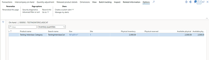

Now, locate the on-hand inventory of this item and see it shows as 2000 cu.in for the block is stored due to above purchase order. See screen shot below for details.
