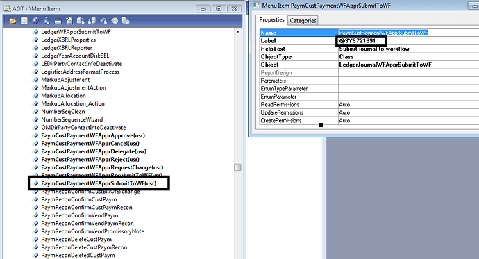

Hello
you can change the button label by changing the menuitems label property
