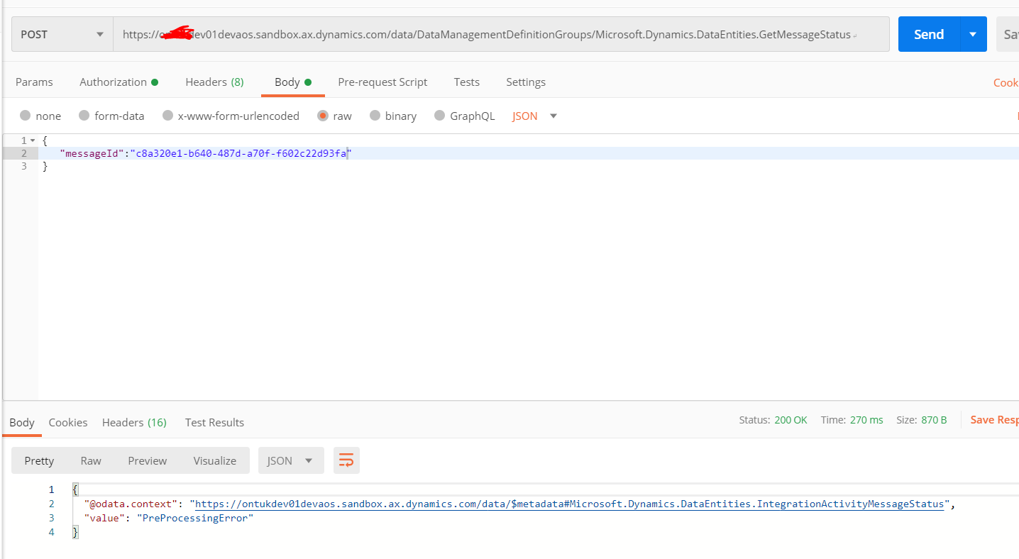

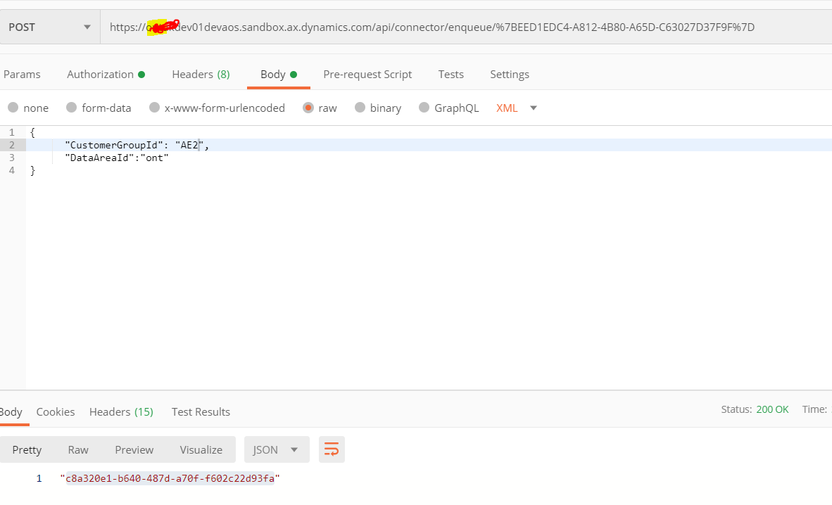

Hi ,
I have configured recurrence for customr group import.
when I try to execute it from Postman using
And the status message is
I tried using both xml and csv as source data format.
Version of F365FO is Update 33
Your request doesn’t specify any entity. Add ?entity=Customer%20Groups to the URL.
Hi Martin,
In the first screenshot,the URL refers to the configured recurring job for Customer Group.
It is referred in MS docs site : ://docs.microsoft.com/en-us/dynamics365/fin-ops-core/dev-itpro/data-entities/recurring-integrations
The request I send reaches D365 and a message is enqueued there. But later it turns as “Preprocessng error”.
I get the same error when integrating with logic apps .
Look at the Docs page again - it confirms what I said. Let me quote it:
API for import (enqueue)
Make an HTTP POST call against the following URL.
https:///api/connector/enqueue/?entity=
In the message body, you can the pass the data as a memory stream.
Example
POST POST usncax1aos.cloud.onebox.dynamics.com/…/{6D31E09F-0249-459F-94F0-AAD9C2C47B64}?entity=Customer%20Groups
Thanks Martin. I am able to import now
