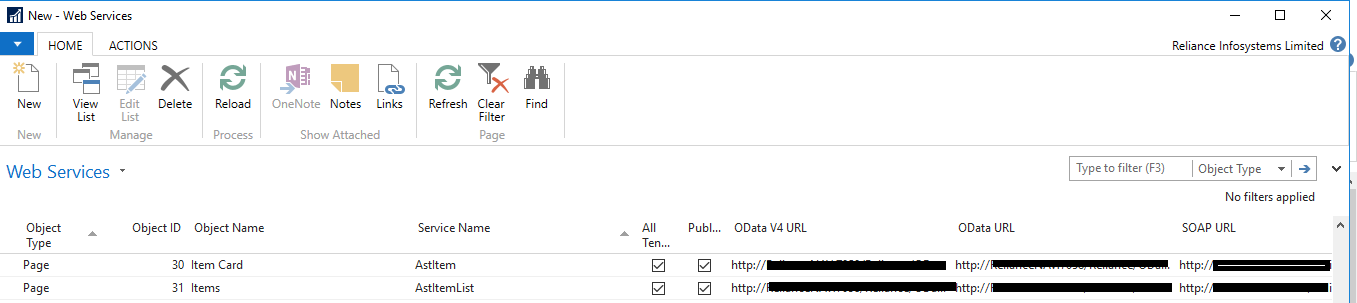

I added a custom field on the item card ‘product id’ which is the product id in dynamics crm, i also made this field a key on the item table.

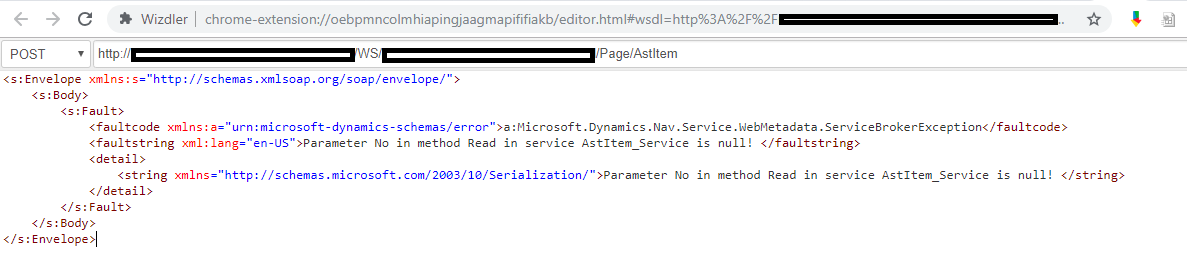

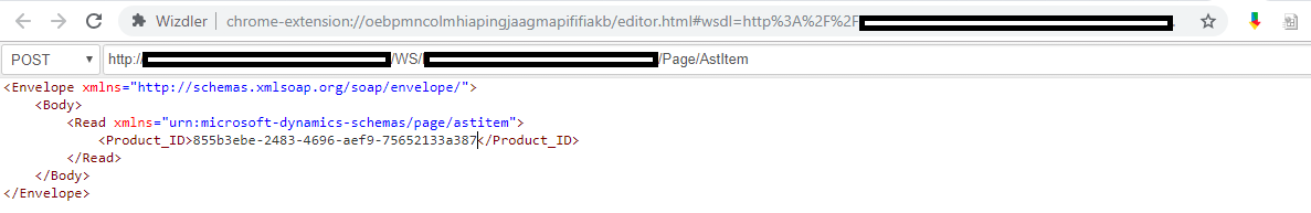

I created an Item web service but i cannot query/get an item using the ‘product id’ field
Below are screenshot of steps carried out and response i got:

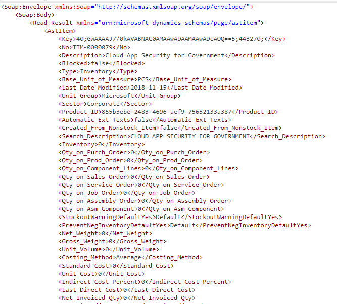

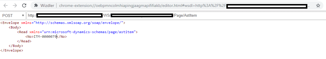

When i query using the ‘Item no’ field, the response return an item:

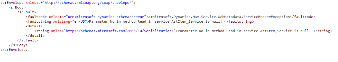

When i query using the ‘product id’ field, the response is ‘Parameter No in method Read in service AstItem_Service is null!’

Can do do the same on any other field? for example Description?
The eror message is that you read-value is NULL and not product id

I have not worked with Wizdler so I am not sure how you post works (I am using WebServiceStudio)
Hello Palle,

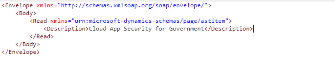

Thank you for you response, i have tried using another field ‘Description’
Below is the response i got:
When i pass the value of ‘description’ field in my earlier post
Rsponse:
How can i change my read-value to product id?

I am not sure if I understood you - Did you mange to read/get a record with a filter on description work?
No, i did not get a record when i filter using the ‘description’ field, it error-ed out with ‘Parameter No in method Read in service AstItem_Service is null!’
I believe the read-value is null because the service is expecting a value from the field ‘no’
