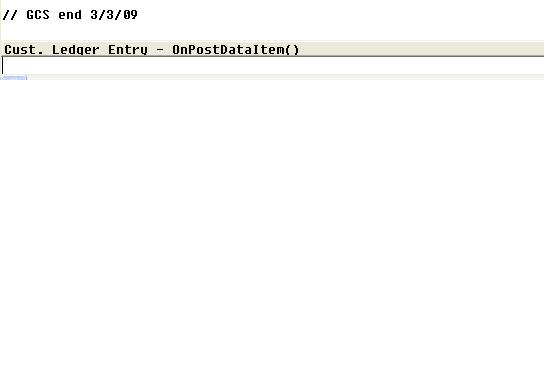

I fixed it Harry.
I added this to the OnPostDataItem.
//Create The Worksheet
TempExcelBuffer.CreateBook;
TempExcelBuffer.CreateSheet(Text000,Text000,COMPANYNAME,USERID);
TempExcelBuffer.GiveUserControl;
glad you got it to work creating the worksheet is a critical part [:P].
