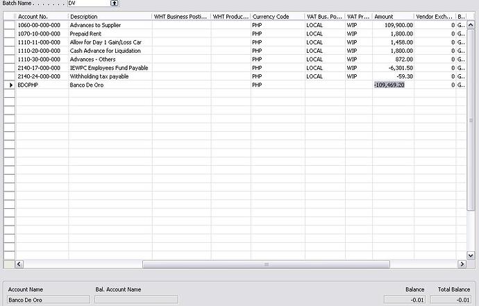

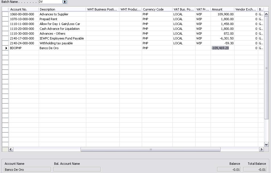

Dear Experts,
I am getting an out of balance of 0.01. I don’t know where and what is the best setup. I noticed this only happens during compound entries. My LCY is USD and transaction is in Philippine Peso
see screenshots…
Your response is highly appreciated!! Thank you so much!

Hello Modris, Thank you for your response. Would you be able to help me where and what exactly do I need to change in my setup for Payment Tolerance? Because I try to find and search help but not very clear to me. Thanks thanks!
Hi Modris, Additional info, I try to look up on the currency code then notice the relational exchange rate was changed. This was supposedly equal to 1. Please see screenshots. What does it means? Do I need to change and edit directly? While on the currency list was setup correctly? Thanks again…
I cannot attached image but anyway, relational exchange rate must be 1, it became 1.00245 ? What would I do??
