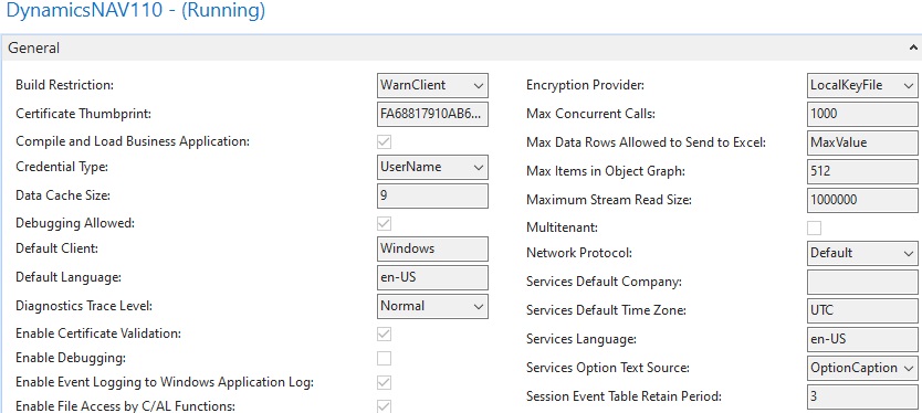

Your added screendumps are in a low quality so it is hard to see what you have done.
What does it say on your upper left corner when you click on the lock? (to see the certificate) - If there are not certificate added you can have three issues
Your CName in your certificate does not match your computername and/or your domain (localhost)
Your DNSIdentity is wrong compared to the name of your Certificate.
Your Certificate has not been installed on the computer as Trusted Root Certificate

You will need to configure also IIS and make sure that you have installed all certificates and make sure thumbprint of SSL certificate is correctly inserted on NST (I think it cannot be copied, but manually typed in).

I believe you need to set Credential Type to NavUserPassword to use SSL Certificate authentication, but I am not 100% sure of this.
Just check the PDF file and make sure SSL settings are configured according to the settings in PDF file and try to open web client.

You should actually use NAVuserPassword - You bitmap is to small to see, and again we cannot help you further unless you present the event log error message.
