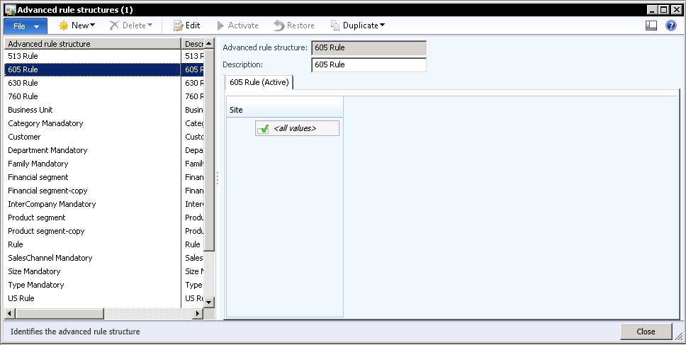

I am not being able to add a segment in an Advance Rule structure in Ax 2012 R2. Is there any setup for this?

Could you give more details on why you are not able to add, what is the exception or a screenshot probably to help knowing the issue better.
Assuming you are following the process correctly as per: http://technet.microsoft.com/en-us/library/hh242096.aspx
Click on the Edit button there… You will get the Segment option to add!
