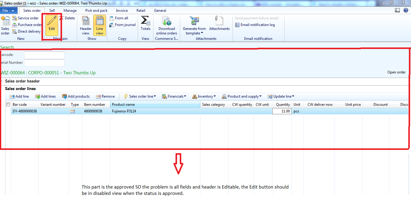

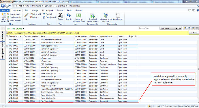

Hi Friends,
I have a problem in my sales order approval workflow. The Edit button and fields in the grid of salestable form is editable should be non editable. I tried to modify using active method in salestable and salesline datasource and override the clicked method in EDIT buttom, but still nothings happen.Please help me :frowning:
Thanks…

Hi Kiran,
Sorry for the late reply.I checked the SalesTableListPageInteraction.setButton
boolean allowUpdate = salesTableType.checkUpdate(false, false);
and in SalesTableType.checkUpdate
I add this codes in the button:
//WORX COSTUMIZATION \
if (salesTable.wiz_SalesApprWorkflowState == WIZSalesApprWorkflowState::NotSubmitted)
ok = true; /return true;/
else
if (SalesTable.wiz_SalesApprWorkflowState == WIZSalesApprWorkflowState::NotSubmitted ||
(SalesTable.wiz_SalesApprWorkflowState == WIZSalesApprWorkflowState::Submitted) ||
(SalesTable.wiz_SalesApprWorkflowState == WIZSalesApprWorkflowState::PendingCancellation) ||
(SalesTable.wiz_SalesApprWorkflowState == WIZSalesApprWorkflowState::ChangeRequest))
ok = false; /return false;/
return false;
all the status is non editable, the NotSubmitted status should be Editable.
