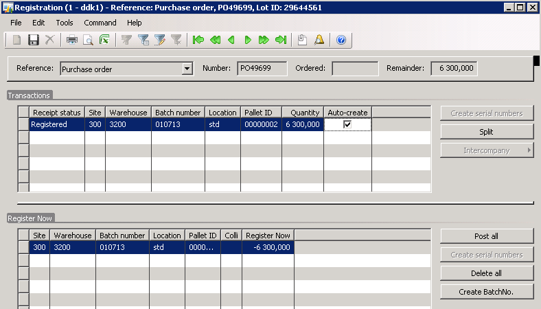

Hi Everyone,
I need to do the purchase line registration and post it as in below form through x++ in AX 2009.
Thanks in advance!
