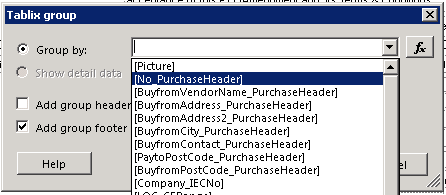

1.In the Body Add Table
2.Add Respective fields in Table
3.add grouping Like Below With Footer
4.Select Location Code Example i have Selected No.
In Footer Add fields Which you want the totals As
Example :Sum(Fields!Qty.Value)
above gives the Total Qty in particular Location…
6.Done Your report.(I assume you know How to add fields in report and how to Use Sum Function)
