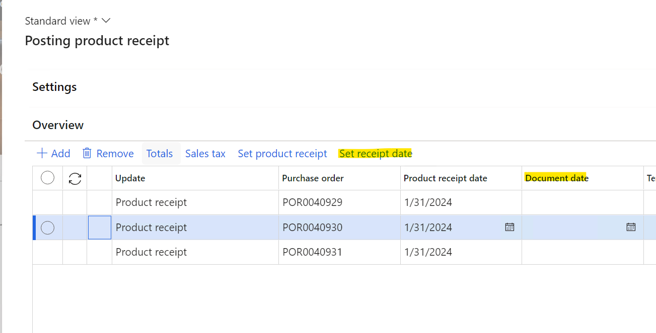

I’m encountering issues when updating multiple records in Dynamics 365 Finance and Operations. I need assistance with the code to reliably select and update multiple records in Dynamics 365 Finance and Operations. The current implementation occasionally updates only a subset of the selected records. Could you provide guidance on improving the code for selecting and updating multiple records?
I think I did - please see my previous reply.
Even after modifying the code as you suggested, I’m facing the same issue.
I see there is issue with the loop.
The loop is selecting the same record again and again. Can you please guide me on this?

Am trying to update all these 3 records at once, by selecting all. But document date is not getting updated.

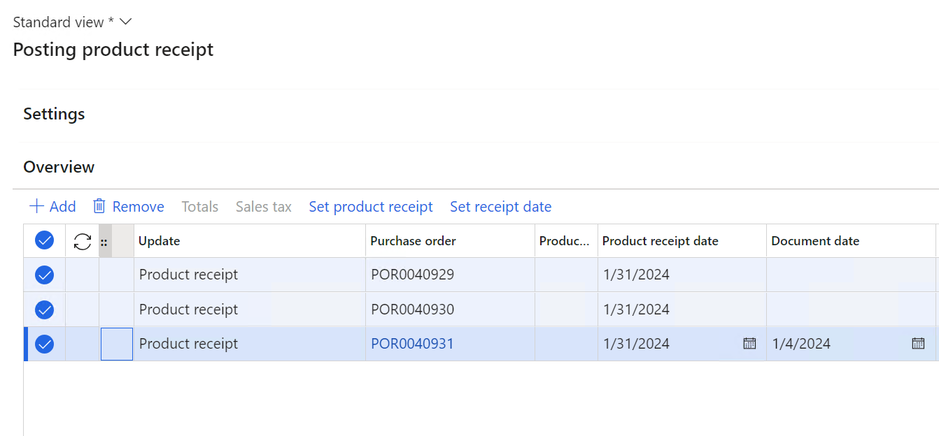

I did tried using MultiSelectionHelper, But this updates only a subset of the selected records.

After debugging the current code, I observed that the iteration is occurring three times, corresponding to the three lines in the form. In each iteration, the input date is being assigned to the document date. However, upon execution, only the last record seems to be updated.
I think the code does its job, you just need to load the updated data to the form. For example, call _purchParmTable_ds.research().
Thank you so much for your time and support!
I’m able to see the values now.
