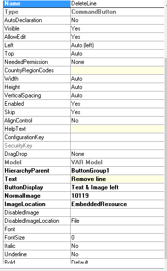

You don’t have to change any code. Can you put a screen shot of your button properties?

Hi Kranthi,
This screen shot for command button properties.

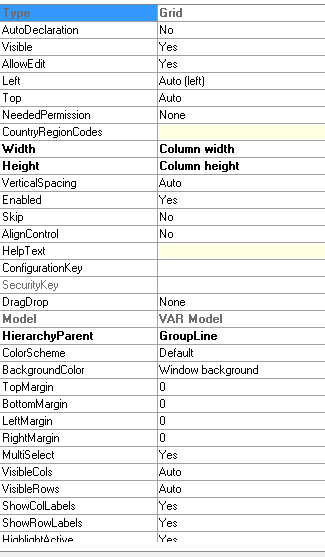

Grid properties.

The screen shot does not show all the properties.
