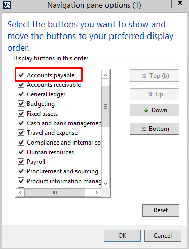

so a module AP is missing in the left screen shot. both of has the security role of sys admin and sales manager
It seems that your scroll bar is not on top. Can you see anything above the Accounts Receivable options? Has the user moved the module else where, as the user can change the order. You can also try to use the reset button for the user, because it will bring back the standard order.
Krupa, i had intentionally added that screen shot. Because my user is not providing me with correct screen shot showing the issue. SO based on the issue explanation the user gave me i had given this screen shot. Basically, the user is not able to see the AP in the given list.
