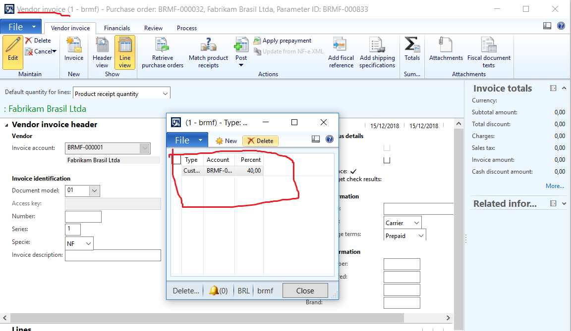

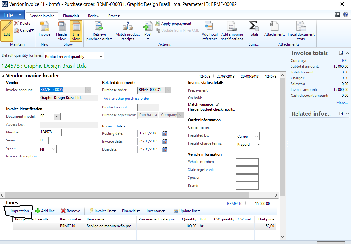

i have the same menuitem in the two forms purcorder and invoice order

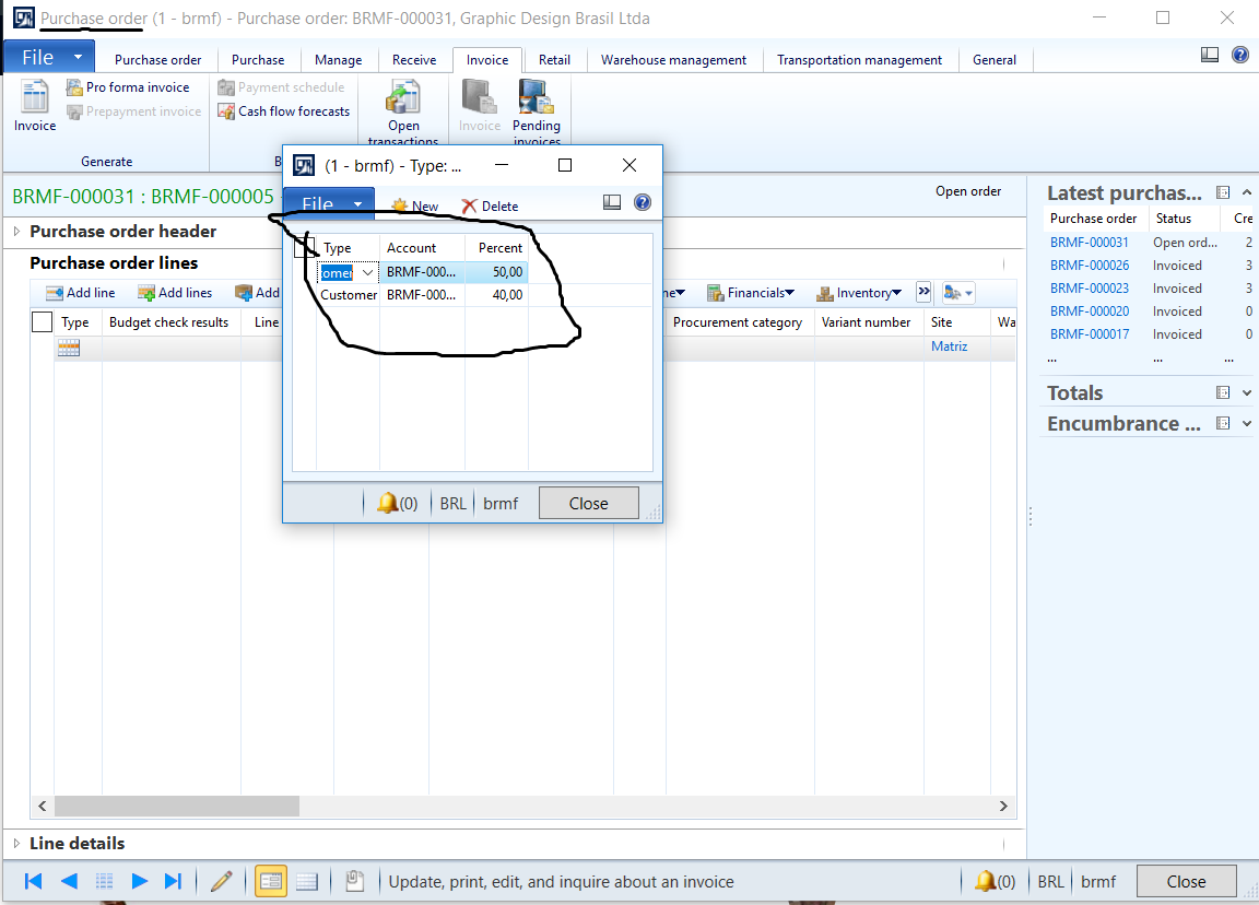

i add two record linked to the form purchorder
and in the invoice order i get the same record when i open the menuitem but if you see i deleted the first record but it have changed in purch order
Hi Wafa1234,
So your question is why system not showing deleted (for your case first line) record in the form which is open from purchase order form. – is it?
— Since your form (1-Brmf) contain datasource which is common for both the form Invoice order as well as purchase order. and there is no data separator for your table because of that when you delete a record from your form (1-brmf) its deleted directly from database and because of that you are able to see only one record from both place.
Consider below example to understand your problem.
I have a form (FormXYZ) and a table associated with this form (TableZYX), I created one menu item MenuItemXYZ. and place this menu item in Invoice order and Purchase order.
Now suppose i opened MenuItemXYZ from PO form and added two line (lets as 1. Rohit and 2. Wafa1234).
Now if i open MenuItemXYZ from Invoice order form I can see these two records — Is it happening with your form?
Now if i deleted first record (i.e. Rohit) from MenuItemZXY which was opened from invoice order form then record (Rohit) is permanently deleted from database. Now If i open MenuItemXYZ from anywhere i can’t see the record (Rohit). – And this is happening with you if I am not wrong.
And as per your requirement system should show deleted record also because that records still not deleted from Purchase order menu item. which is not possible.
If your really want to make system behave like this, then either you have to define some key in your table so that system should understand from where records are created so that while deleting the records system should check whether delete perform from same place from where its create or not. If its same place then it will allow .
Or you have to create another table to store data as per your requirement.

ok the point was to allow delete from invoice order and in PO i keep the same records but the problem i have the same datasource for purchline and vendinvoiceinfoline
Same issue here when I deleted the first record but it still have the same datasource for purchline.
