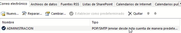

I guess isn’t mandatory to use the O365 account, am I right? Our customer is trying to start session with the same mail account of their outlook configuration, because it hasnt got O365 mail license,…

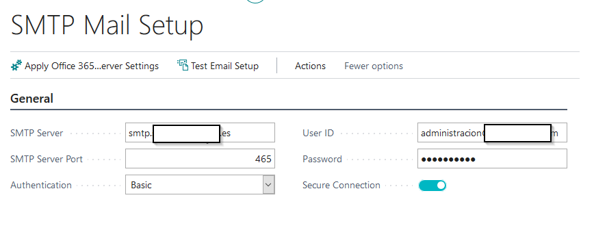

I’m tryng to configure this way:
And i get this error:
And with this:
This error:
I guees I shoul be abble to configurate any SMTp account, but I’m getting those strange issues…

The error-message tells you everything you need to know: “The SMTP server requires a secure connection or the client was not authenticated…:”

Sorry I don’t speak Spanish?? But besides from that your setup is wrong At the top you can see it is POP-settings but your send is SMTP that is definately wrong. For sending the usual setting is SEND.xxxx - but again the provider should be able to give you the exact information.
Palle, the POP section has simply been rolled up in the screenshot and the details showing are the ones that relate to the SMTP side of a “POP” Mailbox for sending (POP3 is a receive only service protocol).
I am not fully aware of what you are saying But the reason that I am mentioning POP is that you have to make sure that the ports that you are using must match to the protocol.
As I do not know the spanish provider therefore I can only see that something is wrong - hey, I don’t even know if they allow SMTP sending.

Hi Palle. I meant if you look in the screenshot where it says “Correo entrante” (means “incoming mail”) it has the little ‘v’ button to expand that section - but in the screen snip that section is collapsed. If that had been expanded we’d (presumably) see his actual POP settings for the incoming mail. The snip then shows the “Correo saliente” (means outgoing mail) section where the SMTP settings are showing. I.e. although it’s the settings page for a POP3 account, he has populated the SMTP section relating to the outgoing mail.
I agree it may be the port and using 587 may work. The message mentions “anonymous mail” which suggests he isn’t passing authentication credentials at all, but if he is then maybe they’re not being accepted because it’s not the correct port.
@aitorNAV please can you check the POP3 part (but please don’t post the details here!). In the SMTP part you’ve ticked to say use the same credentials as the POP3 section (“Usar la misma configuracion que mi servidor de correo de entrada”) but maybe that itself is blank?
