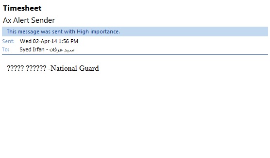

I am working with sending remainder mails for timesheet by batch processing .In my company two type of users available Arabic and English. For English user no problem. But for Arabic users, they cant able to read the Arabic message. Its showing like "??? " instead of Arabic text in outlook. can any have solution for this issue?

yes its encoding problem. I have trace the code line by line, message is encoding on sendmail() method. How we can prevent message from encoding on sysmailer sendmail() method . I’m using Ax2009 version, example code for display the message on mail,
str prjname,body;
prjname = “الحرس الوطني -National Guard”;
body = (strfmt(
project : " + prjname + "
mail.SMTPRelayServer(parameters.SMTPRelayServerName,
parameters.SMTPPortNumber,
parameters.SMTPUserName,
SysEmailParameters::password(),
parameters.NTLM);
mail.priority(2);
mail.fromAddress("from address@company.com","name");
mail.tos().appendAddress(SysUserInfo::find(curuserid()).Email);
mail.htmlBody(body);
mail.sendMail();

So what’s the encoding and charset of the resulting HTML message? Right-click the message and choose View source to find such information.
Okay, that’s the charset in HTML, but does it correspond to the encoding of the file? Isn’t the file in Unicode, for example?
some time the charset is “iso-8859-6” in HTML code after receiving the mail.
actually I’m receiving like this,
