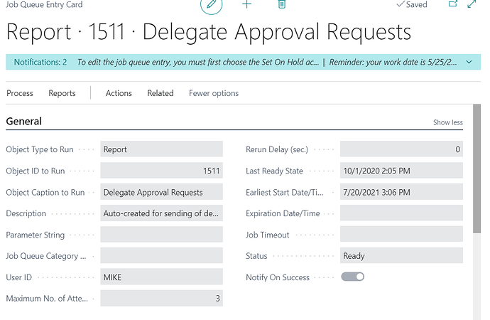

In the Job Queue you can check the Notify on Success Boolean. You will receive emails of the Job Queue.
Steve
This doesn’t notify you of failure though only success, so a job queue that’s running every 30 minutes is dropping you emails all the time and you’re asking the user to notice when one doesn’t arrive. I get you can create rules to filter the emails out or auto delete them, but from a system design point of view it doesn’t feel to me that it’s the best choice for the user

Thanks Steve. A fair chunk of the queues run up to our website every 10 minutes so that probably would flood my inbox! Almost need Microsoft to develop the opposite Boolean [emoticon:c4563cd7d5574777a71c318021cbbcc8]
Kristie,
I follow the flooding you and Phil noted. I would say, as RockWithNAV noted, you can have your Partner/Developer create the Job Queue with pre-defined filters to run 24/7 and only receive FAILED Job Queue emails. In the meantime, you could have the job Queue Log page open to check.
