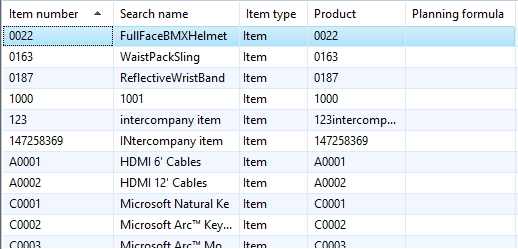

Can anyone explain how ItemId EDT shows the following fields in Lookup when we use it for Dialog field or StringEdit field.?
Thanks in Advance…
Thanks in Advance…

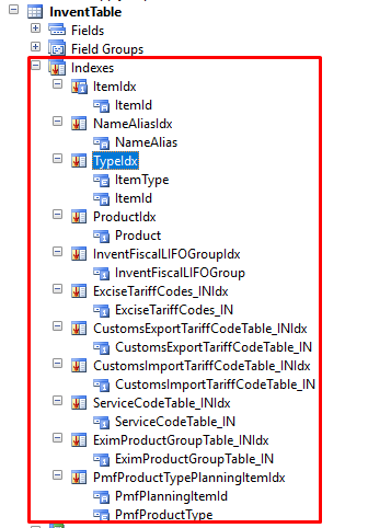

The AutoLookup doesn’t have any field, so it takes the TitleField1, TilteField2 and the first field from all the indexes to build the lookup.
The formHelp on EDT is also not specified. If specified, the lookup should have considered that form.
Thanks for your valuable reply Kranthi…
The available indexes of InventTable are
Then why five fields alone are visible in the lookup?
The other indexes have fields related to specific country (INDIA). Test it in a legal entity that is related to IN.
Thanks Kranthi… Clear now…
