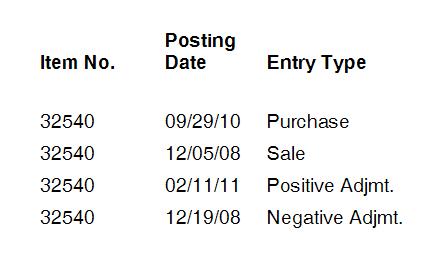

File Save As: 50063 - Test123 - or whatever number and name you need to give it.
run it enter an item number and it should give you every entry type for that item and it’s last date.
now you can play around with the wizard picking other options depening on how you want your report grouped or sorted.

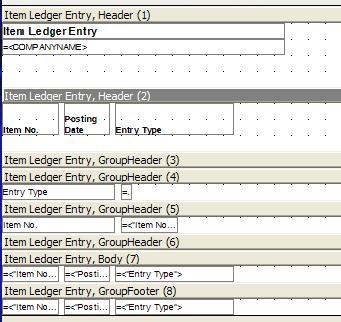

You can View->Sections
as you see here: copy the fields geneater by the wizard from the body to the GroupFooter
Use the CurrReport.SHOWOUTPUT := PrintDetail;
on every section except the footer… so ise it on 4,5 & 7 since these sections print out data//you want to surpress it.
The check box in the request form allows you to show or hide the details.
