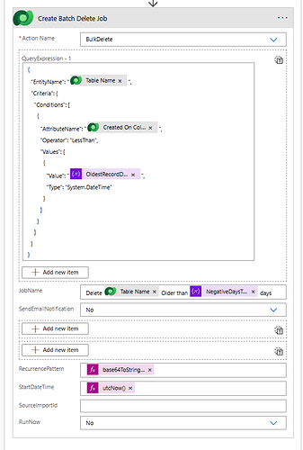

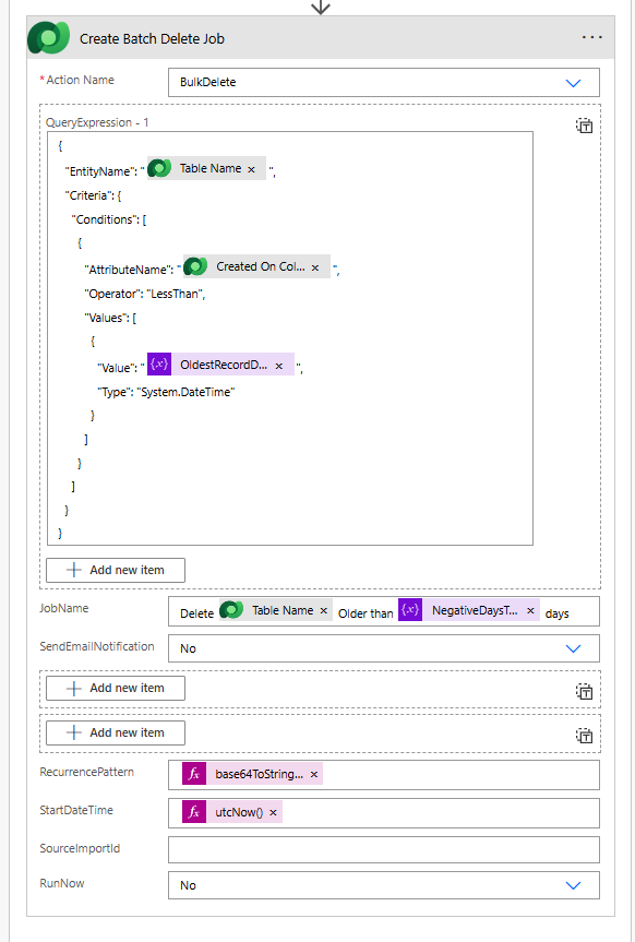

I figured out a way to handle ths using the connector to Perform Unbound Actions. The action name is bulk delete.
I have a control table in Dataverse that list the table name, days to keep and then iterate thought the table I want to perform the build delete on.
We keep this flow in our default environment with the data so it is easy to select the target environment.
