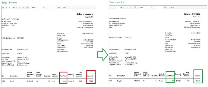

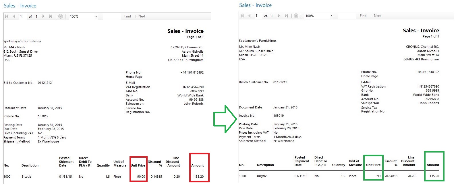

Hi Ramesh,
Hope it helps.
Changed The Format Expression For -
1. Field - Unit Price
Expression - Code.BlankZero(Fields!UnitPrice_SalesInvLine.Value)
Format (Old) - =Fields!UnitPrice_SalesInvLineFormat.Value
Format (New) - =IIf(Int(Fields!UnitPrice_SalesInvLine.Value) = Fields!UnitPrice_SalesInvLine.Value,“0;(0)”,"#,0.00;(#,0.00)")
2. Field - Line Amount
Expression - Code.BlankZero(Fields!LineAmount_SalesInvLine.Value)
Format (Old) - =Fields!LineAmount_SalesInvLineFormat.Value
Format (New) - =IIf(Int(Fields!LineAmount_SalesInvLine.Value) = Fields!LineAmount_SalesInvLine.Value,“0;(0)”,"#,0.00;(#,0.00)")
Int Function Returns the Integer Part in a Number. If the Number will be Integer the condition will return True else False.
0;(0) - Format for Numeric Part.
#,0.00;(#,0.00) - Format for Decimal Part with Thousand Seprator
Hope it resolves the issue.
Hi Saurav,
Thanks For reply…
it works Fine but integer values didn’t Get Thousand seprator…
Thanks and Regards,
ramesh.v
yes i got the solution when i chage it like as
=IIf(Int(Fields!Ordre_Amount_G.Value) = Fields!Ordre_Amount_G.Value,"#,0;(#,0)","#,0.00;(#,0.00)")
Thanks Saurav…
