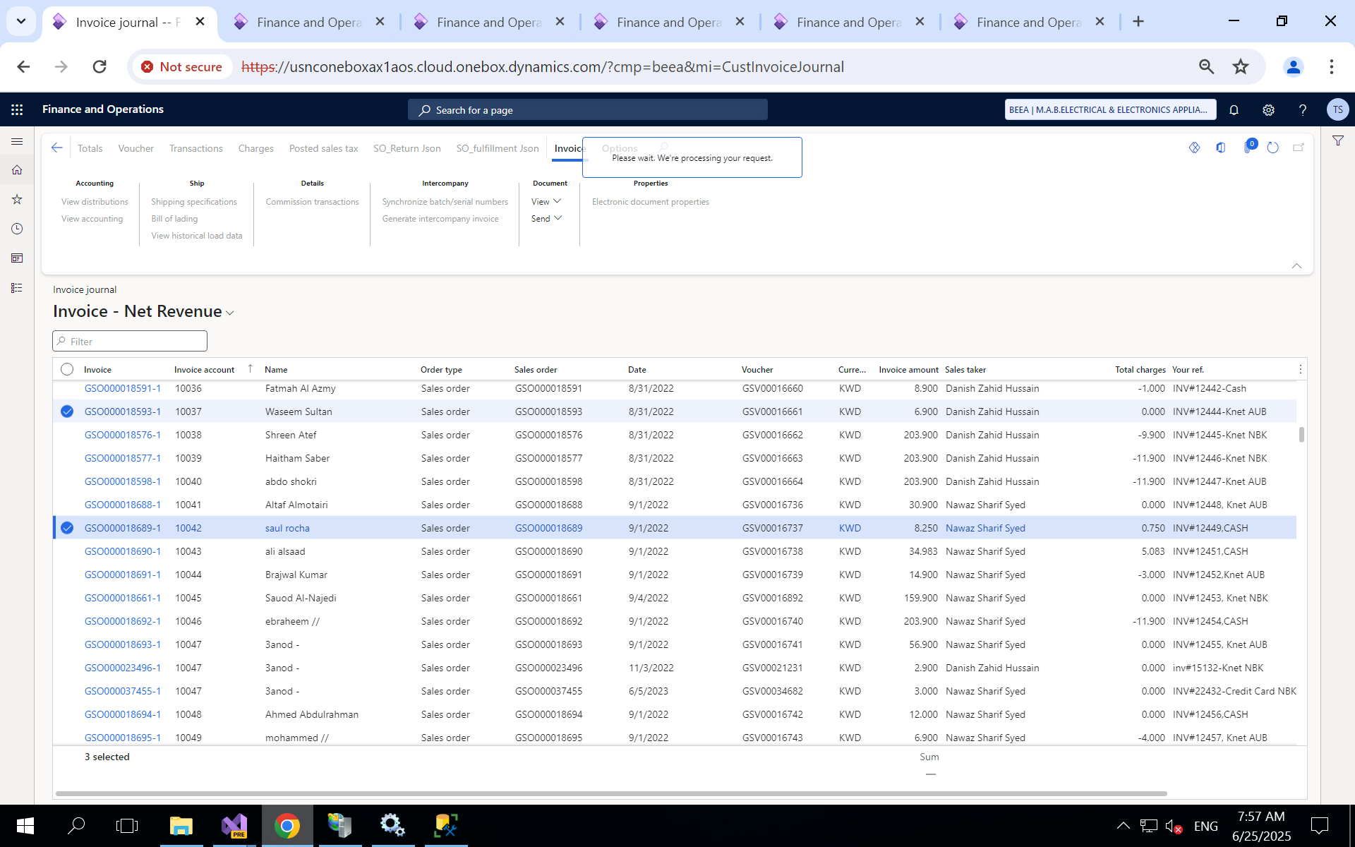

I have requirement for report i.e when user select multiple sales order form the sales list page and when he run the report then it should run for all the selected sales orders

i have selected two sales order record when i go action pane Invoice> document> View > Original preview it will run the report for the two sales order and open two report for that
