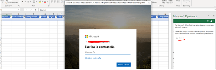

  3. Press the Open in Microsoft Office button at the top right corner
  4. Select Open in Excel: Inventory movement journal headers and lines. Press Download (Picture #1)
  5. Open the downloaded file, press Enable editing
  6. If necessary, Sign in to your environment. Excel will show you the line manually crated in the journal in D365 (Picture #2)

Thanks for your support, how sign in to the environment from excel I couldn’t find it.
